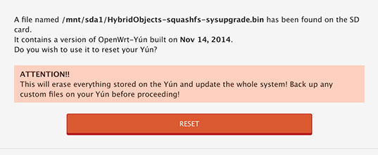

Is the following message showing up when you reach step 13 from the installation guide 2?
Are you able to successfully reset the Arduino Yun with the Button?
