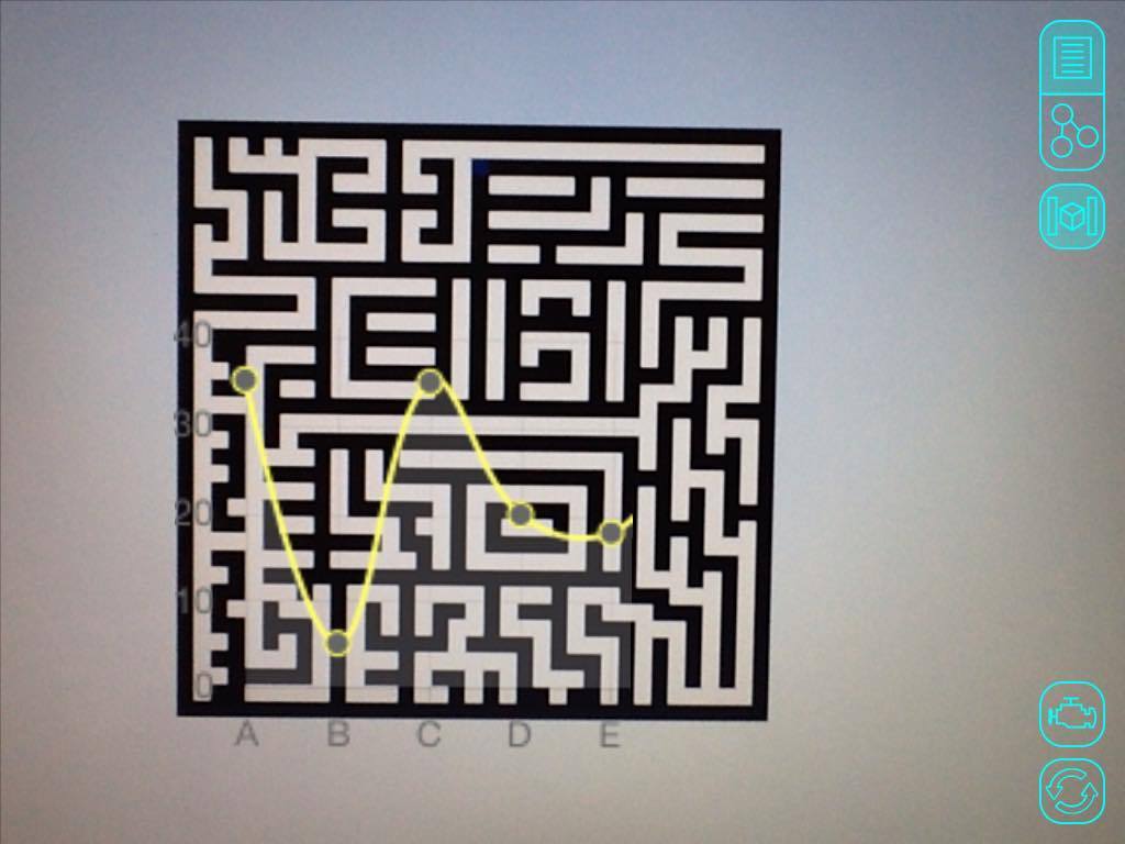

@valentin i have an idea for implementing the HTML 5 line graph as AR element to show real time values
we can store the the incoming data from the required I/O point to an array which is updated with every incoming data and then redraw the line graph with the updated array every-time the array is updated,
i have begun trying to implement it, waiting for the reality editor to update :slight_smile:
The latest version is still in review. I think it should be public sometime next week.
After playing around with HTML for sometime ,finally got a chart with predefined values to get displayed
next step , making the chart update with incoming values by removing some of previous values from beginning of array and adding new values to end of array
UPDATE : now the graph updates dynamically when it is augmented ,

i only want to receive value from the server,( in my case the value of the sensor ) ,here no input is given from the editor like in case of slider ,i need to update an array with the changing values from the server,
@valentin how can i do this ?
You need to send a obj.readRequest("<your IOpoint>");
If you want it to be updating in realtime, then you need to but the read Request in a loop.
Thats what happening with
 setInterval(function () {
  }, 50);
Watch out that you have a delay (50) between the requests so that the object server is not overwhelmed.
Once the object sees the read request, it will send back the requested IO-point value.

Yeah! such a system would be awesome , students can just point their device at the apparatus and obtain values in the form of graph or other form directly
i will refine the code a bit more and create backup :slight_smile:
@valentin @pcook77 here is sample video of how it looks (sorry about the bad lighting)
@V_Mohammed_Ibrahim I love it! :smile:
If you print out the marker and pin it close to the sensor, then you can move the iPad around and it would look like the graph is actually part of the sensor. What do you think?
