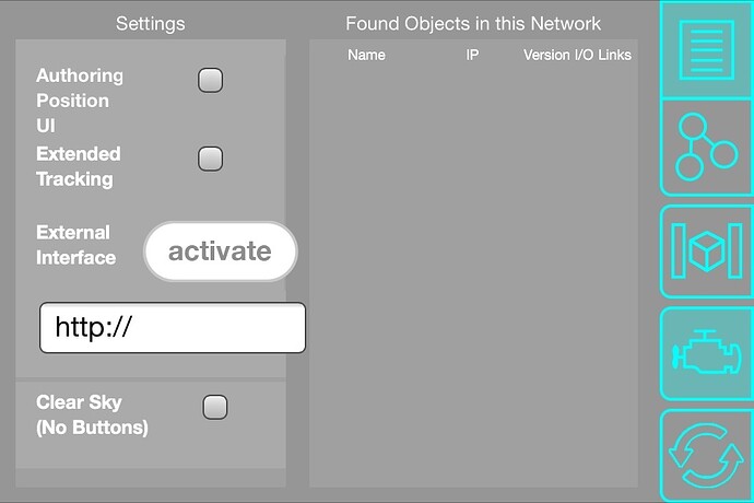

at this point we have tried reality editor on a Iphone 6S (IOS 9.3.5)
in order to test the bird example… to no avail
No object found, and the QR code shows no bird
what are we missing?
Stefano
Hi @stevepayne,
the Eduroam Wifi is the problem.
It does not allow the UDP broadcasting. Which is a problem with all cooperate and university networks.
You will need to create your own private wifi network with a consumer wifi router.
