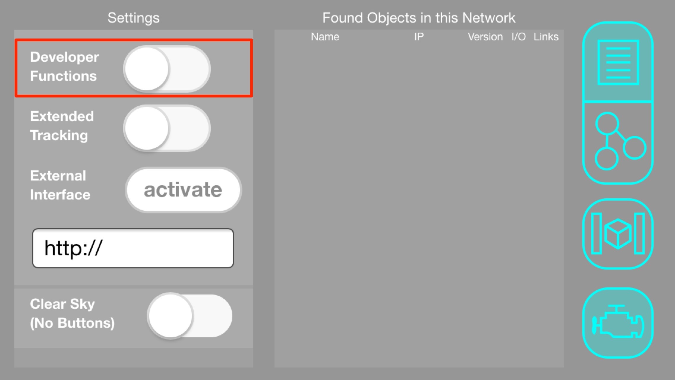

I think that would be better and I found the switch cannot be disabled once it is enabled.
Device: iPhone 5S
Reality Editor: 1.5.7
What do you mean by that? How can it not be disabled?
Once I turn on this button on, I cannot turn it off. I usually delete the app and install the app again.
Also, I cannot switch Extended Tracking button. Do I need to do something before I can turn on this button?
What iOS version do you have?
Can you try to load the Reality Editor in Airplane mode?
Can you enable and disable the buttons when you are in Airplane mode?
Hey! It works.
I can switch both buttons on/off in Airplane mode and they can be controlled when I turn off the airplane mode.
How come it work like this?
iOS version: 9.2 (13C75)
I have the feeling there is something wrong with your Arduino Yun and it is sending wrong data to the Reality Editor. The consequence is that the Reality Editor generates an error and stops the entire Javascript GUI.
When you are in airplane mode, the data will not be received and there is no error.

@valentin i also came across the developer button problem , but was able to switch off after some tries, it must be some problem with the app, it was like the buttons were not responding to the touch
I know, these buttons are a bit hard to operate and sometimes you need a couple of tries.
I will try to implement better responsive buttons down the road.
But the problem that @ivanlin has nothing to do with the operability of the buttons.
@ivanlin please share the object.json files that are in the object folders of your Yun SD-Card. We will then be able to see what is going on in your objects.
