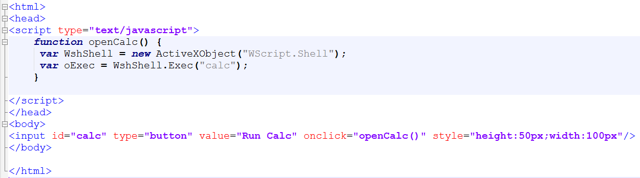

  2. I put a button in index.html, and what I want to do is when I click this button, my windows laptop can open the “Calculator” application (it just need to run ‘calc’ in windows cmd).
    The simple code of index.html is:

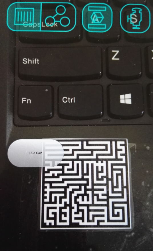

  1. Upload the index.html to http://localhost:8080 1, I scan the laptop HRQR use Reality Editor, and then I get this picture:
When I click the Button, there is no calculator started in my laptop.
This is the example, I just want to try whether I can control my laptop with the Open Hybrid Platform and Reality Editor.
Ahh I see.
The interface that you see in the reality editor is not like a webpage on your desktop.
The ActiveXObject would only open the Calculator if you would open this webpage with a browser on your desktop.
