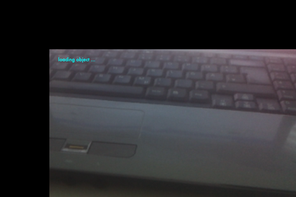

Hello! I’m experiencing some video scaling issues on the iPhone 6 Plus. Attaching a screenshot for review… this occurs consistently after the title/splash screen on startup.
This error must have slipped in when I debugged for the non retina displays.
You can see with the earlier versions that we where debugging similar displaying errors for the iPad2.
I have all of these devices for beta testing here for the weekend.
I hope this will be the final bugfix for the scaling issue.
I have fixed the scaling issue for devices that have an extra size retina display such as the iPhone 6+.
The problem was that all other retina devices have a scale factor of 2. The iPhone 6+ has a scale factor of 3.
A new version 1.5.7 is successfully tested with iPas2, iPad3, iPad4, iPad mini, iPhone5s, iPhone6+ and is waiting in the app store for review.

@zippi The error you get disappears when you rotate your phone so that the orientation changes.
Please let me know if this works.
