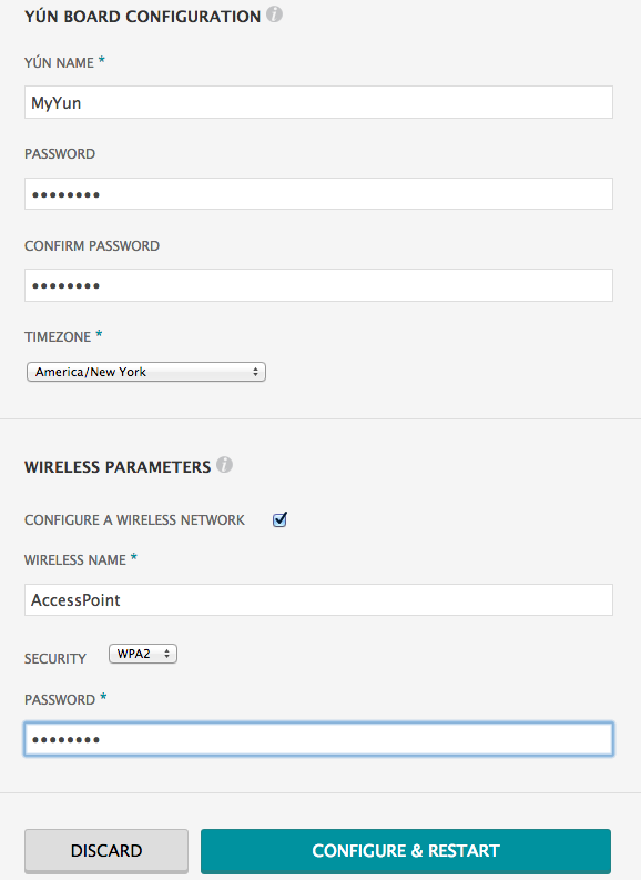

But this time you change the wireless parameters. It looks something like this image here:
Then push restart and your arduino should be loged in via the new network parameters.
