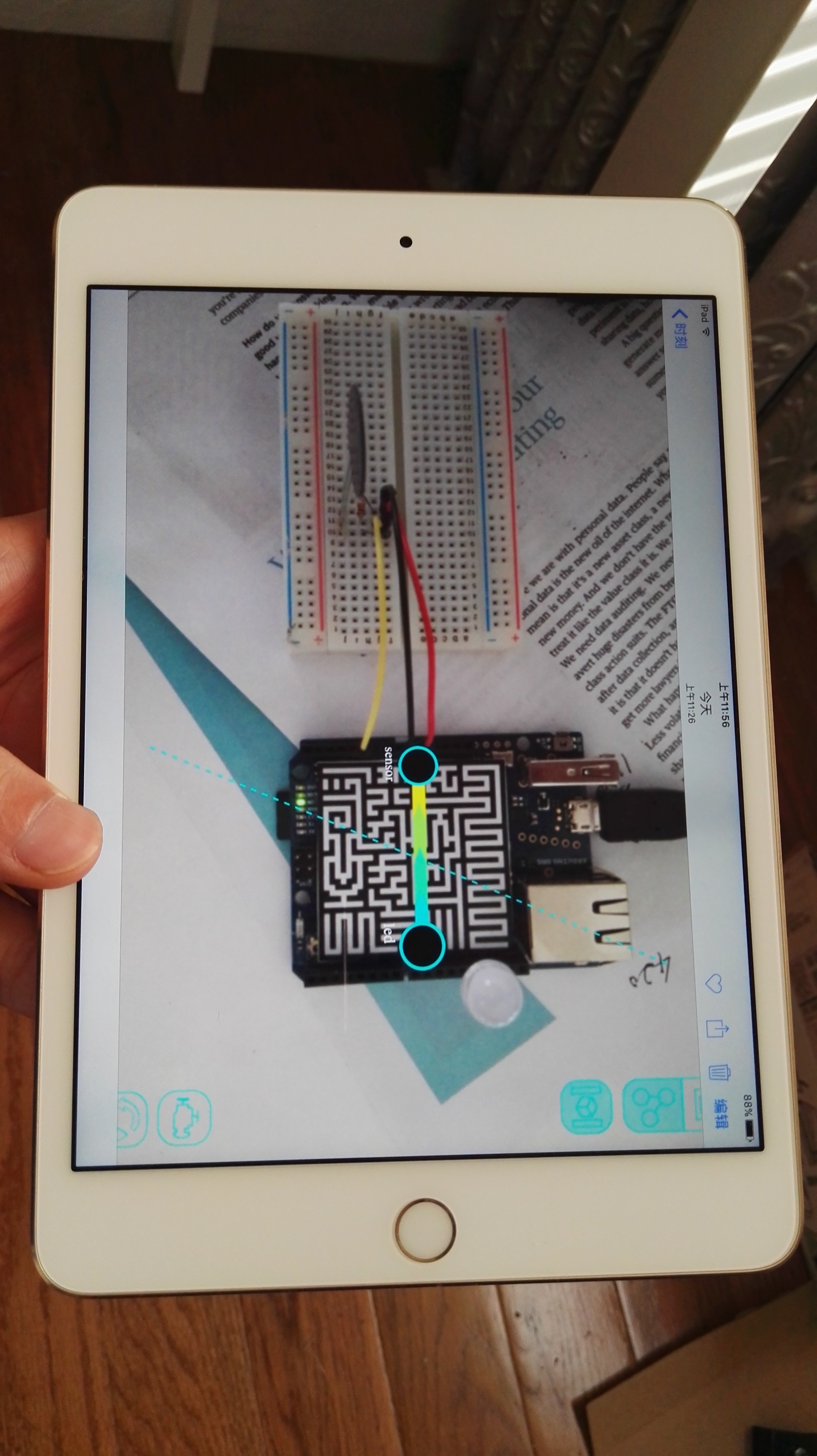

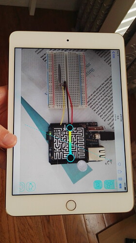

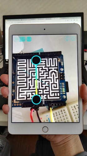

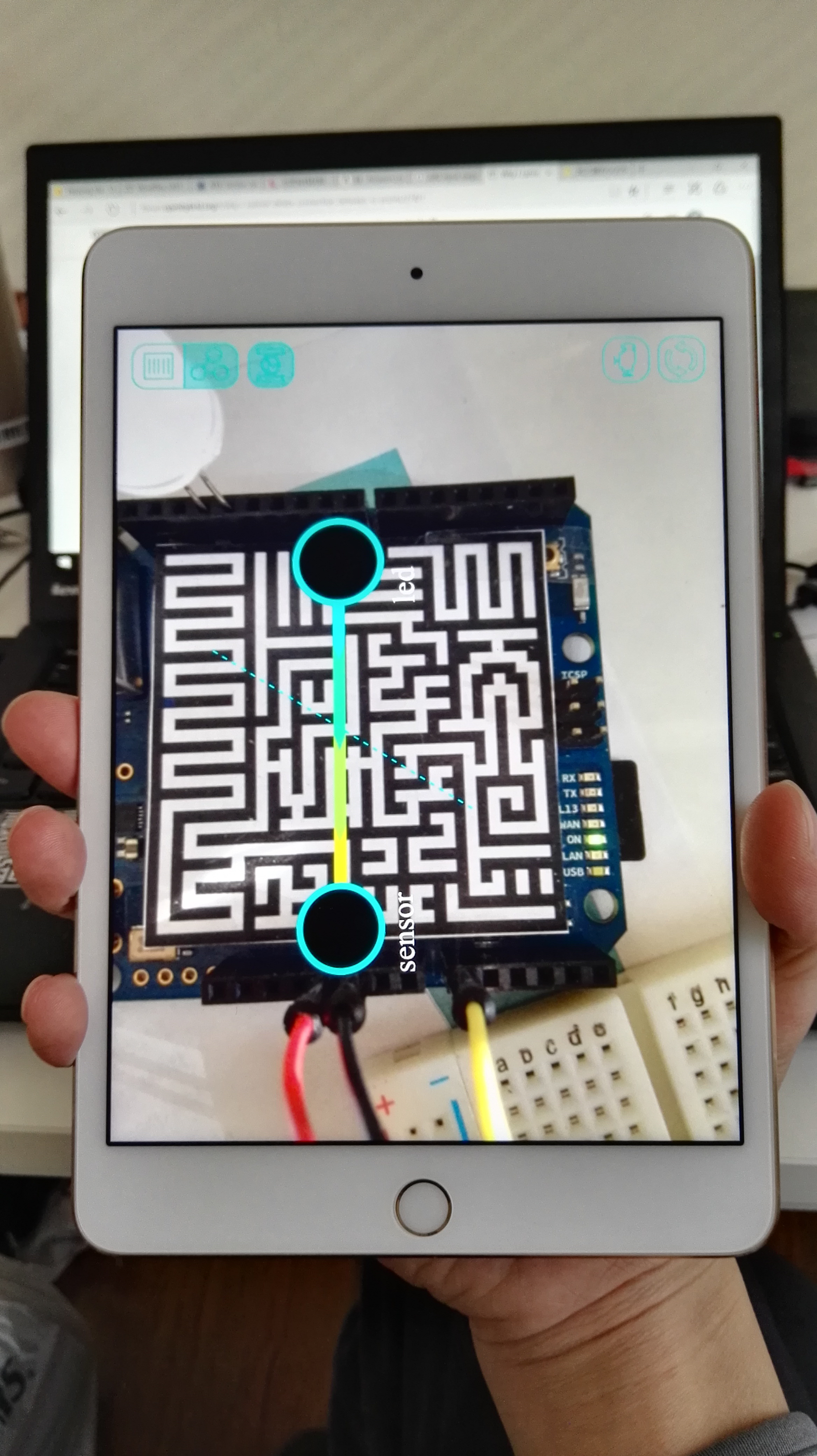

The problem is when I try to delete the connections of io points in reality editor, the connection cannot be deleted.
When my finger leave the touchscreen, there is a dotted line remains there.
I try to reboot app and open hybrid sever, but it doesn’t work. This used to be ok several days ago. Anyone knows how to fix it?
