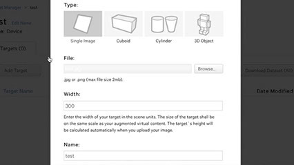

  2. To make sure you see the augmented interface, check following:
    1 . Upload the same JPG file to the backend server on Arduino Yun and to the Vuforia server for creating zip file.
    2 . Create a Hybrid Object with name of slider. The backend server will show up a new page and state a name like sliderxxxxxxx. Use this name to create a target on Vuforia server. Fill in 50% width of original image’s width in the field of Width (e.g. fill in ‘300’ if the width of image is ‘600’.)
    3.Download the dataset file as a zip file. Don’t uncompress. If you use Mac OS X. Turn off ‘Auto Open’ option of Safari before you download it.
    4.Drag the downloaded slider.zip to the backend server on Arduino Yun like video shows.
    5.Click ‘back’ button on top the screen you should see both “Target” and “Interface” buttons are in green. Keep this in mind becaue it is important milestone to know you are in the right track.
